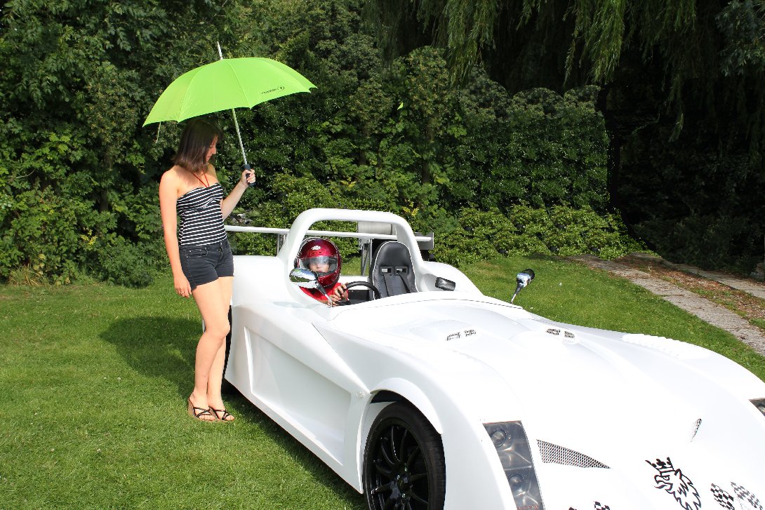

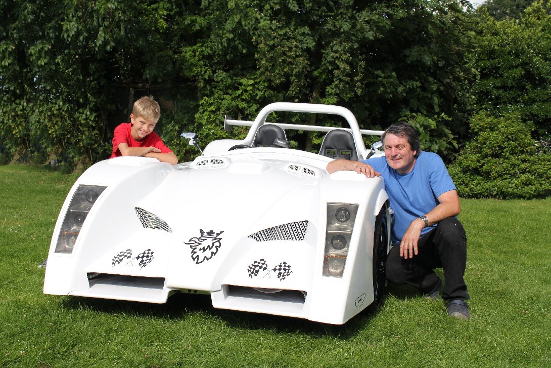

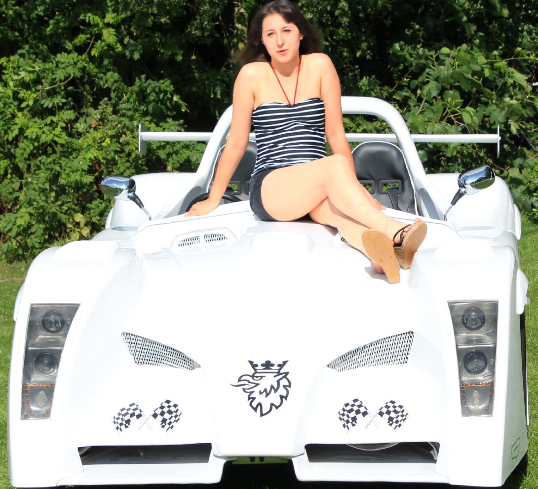

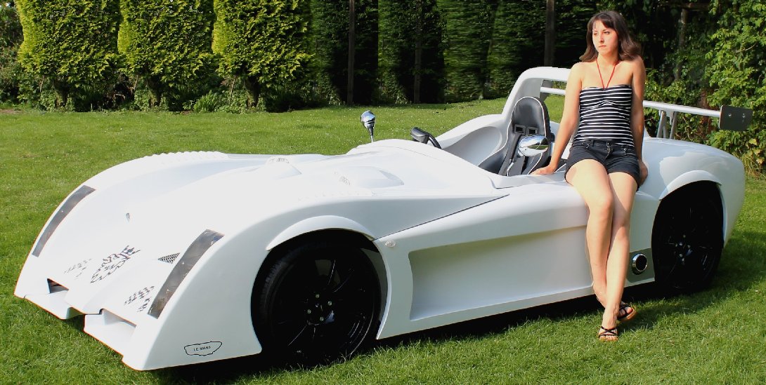

A  1998 GM900 in dull silver with very bent side panels and 154K miles is transformed!!
This project has taken exactly 2 years to date (24/07/11).
Here are some photo shoot pics just before it's all stripped down to have it's new rasied sump fitted. Could be the last time it's seen alive as it may not recover from the anaesthetic (or my fabrication work or my welding etc etc etc.....) :o
Big thanx Lena for spending the only sunny day of your holiday away from the beach & the loan of a brill camera!
The transformation team!
We had better stop looking so smug coz there is loads of work to do yet  :-\
